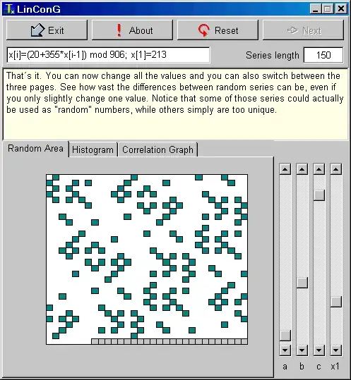

Related to "graphical calculator"
Well, it is probably not what you were thinking of as it doesn't attack any LCG, but there is a piece of software that allows to experiment with the parameters of an LCG and which visualizes the subtle correlations between the pseudo-random numbers successively created by an LCG.
screenshot of the software
You can grab either the English or the German version at
http://www.vias.org/simulations/simusoft_lincong.html
