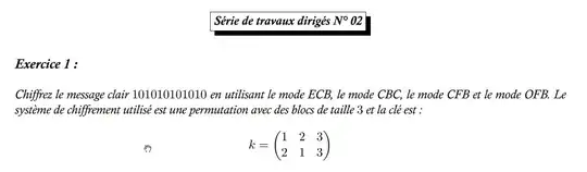

Given this plaintext: 101010101010, and the block is 3, with a IV = 000 and the key as k = |1 2 3| |2 1 3| What are the required steps to get the same result like these in ECB mode: c1 = Ek(m1) = 011, c2 = Ek(m2) = 100, c3 = Ek(m3) = 011 et c4 = Ek(m4) = 100. c = c1||c1||c1||c1 = 011100011100.
Note: It is not a homework/ test, I just making some preparation.
Full exercice and its solution are bellow: enter image description here

  • the concept "matrix key" is nonstandard and unclear. also, smells like homework / test question, which is off topic – kodlu Jan 29 '23 at 13:24
  • @kodlu This is not a homework, this is preparation and it happen I am trying to solve some exercices. – H Aßdøµ Jan 29 '23 at 17:43
  • ok, seems to be some Mini AES resembling block cipher. Still your terminology is meaningless without further info, you should translate the details from french. What is the alphabet? Etc. etc. – kodlu Jan 29 '23 at 17:45
  • The underlying 'block cipher' you are expected to use is simply a permutation of three elements, defined by the key $k$. That is $k$ defines a permutation $\pi$ such that $\pi(1) = 2$, $\pi(2) = 1$, and $\pi(3) = 3$. Its domain and co-domain are thus bit strings of length three. – Morrolan Jan 29 '23 at 17:48
