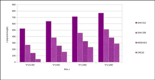

The Left over hash lemma (re-arranged) is:-
rule 3
where we have $n$ = input bits at $s$ bits/bit of raw entropy from the source, $k$ is the number of output bits from the extractor. $\epsilon$ is the bias away from a perfectly uniform $k$ bit length string, i.e. $H(k) = 1 - \epsilon$ bits/bit.
This then allows setting the input/output ratio to choose an output bias $\epsilon$. I use $\epsilon = 2^{-128}$ with SHA-512 because I can. Other ratios for interest are:-
extractors
Having read one or two papers (!) and built many TRNGs that pass all randomness tests, I suggest the term you're looking for is randomness extraction. The quality metric is the Left over hash lemma. Cryptographic functions are not required.
Understand the raw entropy source, pass randomness tests and you're shiny.
