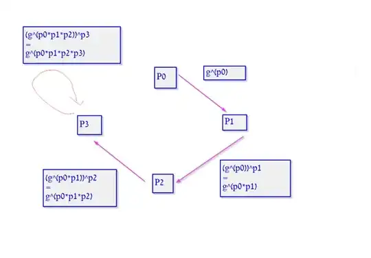

This answer compleat "Paŭlo Ebermann" answer with a grafical view.
Let's show it for 4 parties: The public values are: g: generator.
Let's make it a bit more hard and assume that each of them can talk only to the next one:
P_0 -> P_1 -> P_2 -> P_3 -> (cycle) P_0 -> ...
Assuming no "man_in_the_middle" attack, you can do this:
  1. Each participant chooes a secret random key: P_0: p_0, P_1: p_1, P_2: p_2, P_3: p_3
  2. Then each one of them P_i sends it key performing almost full cycle, ending at P_(i-1) which allows all of them to share the same key: p_0*p_1*p_2*p_3
This way: enter image description here
And this is how man_in_the_middle attack will look like: enter image description here
