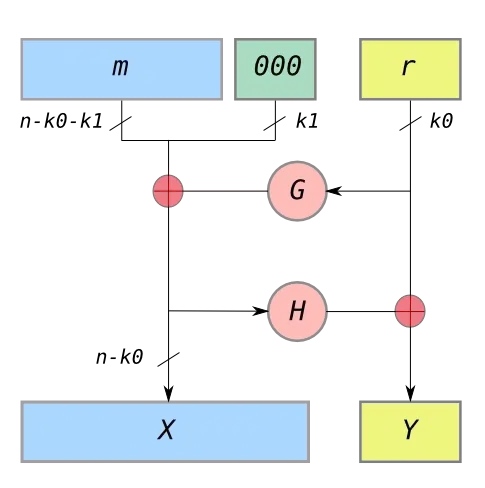

The question then becomes: how should we pad the message $m$? OAEP is one such padding scheme (there are actually many ways how this can be done, but not all of them are secure. RSA-OAEP fortunately is). So how does OAEP-work? You should check out the description on Wikipedia, but this picture goes a long way of explaining it:
$\hskip 2 in$
After the message you pad with some zero's then append a completely random string $r$. Then feed these through a couple of hash functions $G$ and $H$ and some XOR-applications and output the padded message $x \| y$. Then you encrypt this padded output. When you decrypt you basically reverse the whole process and verify that you have the right number of zeroes at the end (before the $r$).

  • Note wikipedia describes and shows the original publication by Bellare&Rogaway. The scheme specified in PKCS1 v2.0+ is slightly different: the order of inputs is reversed, the rigid padding is slighly different, and it adds a binding (via hash) to contextual data (called parameters P in 2.0 and label L in 2.1+). This doesn't change the concept or (AFAICS) the security analysis, but it does matter to implementation. – dave_thompson_085 Feb 05 '19 at 03:08
