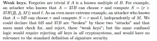

  • Bernstein et.al. argue that excluding weak keys (including zero) is not a way to go: enter image description here
