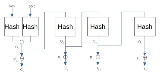

You are using SHA-256 in a chaining way to output a stream to encrypt the message with x-or;
\begin{align} O_1 & = H(key) \oplus H(message)\\ O_i & = H(O_{i-1}) \end{align}
Then the encryption is executed with x-oring $O_i$s.
$$C_i = P_i \oplus O_i$$
Now assume that you have a known-plaintext for some block $j$. This means that you get $O_j$
$$O_j = P_j \oplus C_j$$
Now use the stream producing equation
\begin{align} O_{j+1} &= H(O_j)\\ O_{j+2} &= H(O_{j+1})\\ \vdots \quad & \quad\quad\vdots \\ O_{j+t} &= H(O_{j+t-1})\\ \vdots \quad & \quad\quad\vdots \\ \end{align}
As you can see, you get the rest of the stream output from the position $j$. If you have the first position then you will get all.
This is the weakness of such a scheme on the other hand the CTR mode is designed for PRFs and it is common to initialize it with some good hash functions.
See with an image
As one can see, if you get any of the output $O_j$ then you can get the rest due to the hash chaining.

  • So XORing Oj with Cj should yield the plaintext of block j? Thanks for the image, it helped me understand your explanation better. – CrazyPhil May 18 '22 at 13:36
  • Furthermore, what exactly is Oj? Because it obviously isn't the finshed hash, correct? Because H(key+ptxt) = C1 not O1; so when decrypting this in a program, how would I yield O1? – CrazyPhil May 18 '22 at 13:43
  • That is why I draw it. Sometimes an image can tell a thousand words. $O_j$'s are the output of the hash function. When decrypting just x-or the ciphertext with $O_j$'s like in the One-time-Pad. – kelalaka May 18 '22 at 13:55
  • The first hash needs to be $hash(key)\oplus hash(ptxt)$, which doesn't change the attack, I'll correct it later... – kelalaka May 18 '22 at 15:56
