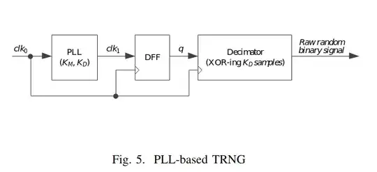

Many TRNG designs are based entirely on digital circuitry, and do not involve any analogue components [see note]. It makes them simpler to incorporate on silicon. But unfortunately digital circuitry tends to perform digitally and is therefore quite poor at generating entropy. So rather than giving you a theoretical example, here's a real TRNG with very very poor bias:-
This is from a paper building an FPGA TRNG.
pll
Notice the Decimator. It's role is to successively XOR $K_D$ samples together in order to increase the entropy per output sample. In this case, $K_D=7$, effectively XORing seven OTPs together from your perspective. Later in that paper, $K_D$ reaches 185 for another design. That's 185 biased TRNG samples XORed together using the Piling up lemma. I can't find the reference for you, but I've seen a decimation ratio of 512 in a ring oscillator TRNG.
So you'll find that successive multiple XORing is common in all digital TRNGs in the form of decimation. It avoids more complex entropy extraction techniques such as hashing which require more silicon real estate.
