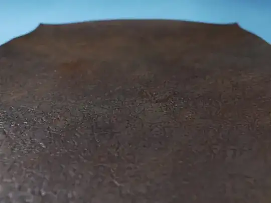

I recently stumbled across a clever way to make impressive-looking fake leather from craft foam sheets that would be great for costume purposes:
The process is described in Make Fake Leather From Tinfoil and Foam! - Instructables. The link is a good tutorial. The process is basically crumpling and then flattening tinfoil to create a wrinkle pattern. The tinfoil is placed on the foam sheet and pressed with an iron at the lowest setting. That textures the surface. A few colors of acrylic paint are wiped to give it the final appearance.
