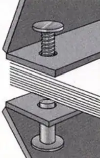

Proposed Alternative: Traditional Scrapbooking in a Post-Bound Album: In agreement with @ChrisH, below is a list of “pros” for a scrapbooking approach (which is, the use of adhesive or mounting corners to adhere your memorabilia to album pages.)
I am specifically recommending Post-Bound albums, which have special expandable bindings that use 2 or 3 metal binding posts (screw heads on both ends of a post, one stationary, one moveable) to tightly hold the pages between the front and back covers. Using an album with three posts is much sturdier for a thick, heavy project.

Pros:
  • One can easily achieve the look of a bound book, even on the back of the spine.
  • Post-Bound scrapbook bindings are expandable, allowing for the addition of more pages by changing to longer post screws.The longest posts I found are these 60 mm posts on the Michael’s website.

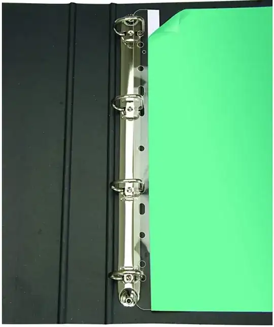

An option I've often used is self-adhesive binder strips. They're typically about 1" wide clear mylar that's pre-punched with standard looseleaf holes on one edge and an adhesive strip on the other. You stick it onto the edge of the document. There are a few styles available like these:
enter image description here Source: Amazon
For small items, you can cut the strip to a shorter size and use just two of the binder rings.

  • Very interesting option, thanks! The only two downsides I can see are the price and the labor need to attach pages one by one. Still not too bad. – vitaly Nov 29 '19 at 21:21
