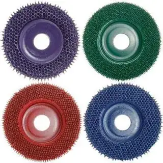

There are many pictures in your link, and they use a mix of techniques. This will be easier to address if you identify specific ones. The one you put in your question looks like two kinds of actions.
The slots look like a circular saw was pressed into the wood, centered over the textured area. My first impression of the background texture looked like a wood carving wheel on an angle grinder used in different directions. There are different types available. Here are a few used for rough shaping (images courtesy of Home Depot):
Some of the initial rough shaping of the "trough" may have been done that way. Some of the surface grooves are long arcs that are narrow and clean, so they may have been done with a sanding disk or reinforced fiber cut off wheel.
But the actual finished surface you see couldn't have been done that way. Closer examination shows that the texture stops abruptly at the slots, and varies substantially from one side of the slot to the other. A large diameter circular tool couldn't be used to do that. The only tool I can think of that would let you do flat, independent depths between slots would be chisels. So a lot of meticulous work went into that piece, despite how rough it looks.
