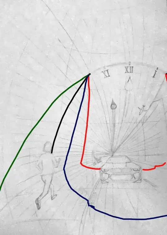

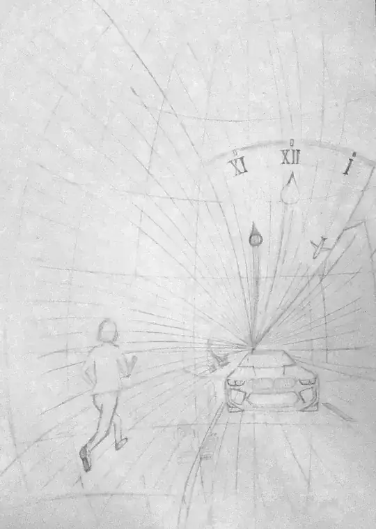

I'm sketching an ink drawing. It's going to be black and white cityscape with a sun in the background. The perspective is twisted and I have no idea how I should place the line between the part which is lit by the sun and the dark side. Does anyone have an idea? I attached the original sketch and my ideas beneath.
Thank you!
Sketch: Sketch
My attempt: Attempt

    Hi Daniel. Can you explain your question in more detail? I think you mean you want to draw where the sun hits and where it doesn't, but it's not clear where the sun is in your drawing. – Joachim Feb 01 '19 at 14:59
    You should clarify the scene and setting as well. At first glance the car seems to move out of a tunnel. At second glance there seems to be a plane flying on the tunnel's roof, so I suppose it's actually sky. Are those walls or buildings left and right of the car? Where is the sun supposed to be? And what do the diffent colors mean in the second picture? – Elmy Feb 01 '19 at 21:50
  • Having a hard time reading the image...What direction is the light coming from and what is casting the shadow that separates the dark and the light? What are perspective guides and what are surfaces? – rebusB Feb 02 '19 at 00:49
  • Sorry I hadn't have the time until today. The Clock in the Background is the sun. And I'm not sure where the shine from the sun is supposed to end as it will be a black white ink art – daniel Feb 07 '19 at 13:31
Basically, you'll want to use a perspective-based method of drawing shadows, such as the technique I demonstrated here: How to calculate the shadow direction, size, and transparency?
However, you'll need to be doing a modification on your perspective lines to match the distortion you're doing for the perspective in general. If I'm reading your sketch correctly, you've drawn a warped/wavy grid that represents the perspective, so your light perspective lines would have to "snap" to that same grid. In the end, this just means the the shadows that fall on the ground or objects will curve along the same paths as everything else, and be as "straight" as your sidewalk is.
Keep in mind, though, that the sun is very high in the sky, which likely means that your light source point will be well off your page (unless you're drawing the sun in a low position like setting/rising, then it may very well be on your page).
The shine from the sun will stop where something blocks it: the car, the hands of the clock (maybe), the jogging figure. Not the plane since its shadow will be cast away from the ground if the clock is the sun and is the source of the light. So your shadows will start wherever there is an object between the clock and the viewer.
Since you are using single point perspective and the sun/clock is at the same point as the perspective convergence you already have a big clue as to where the shadows will fall. The light rays will be following the same path as the perspective lines, the distortion of the perspective is not a problem as the shadows will flow along the same distorted lines.
