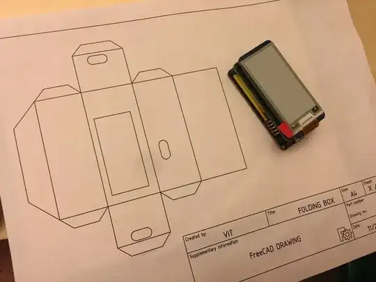

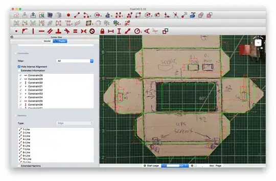

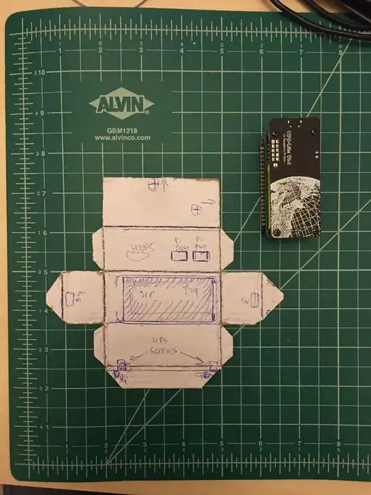

I had to do something similar recently.
Starting with a pencil sketch and a cutout (could be just a sketch in your case), I took a picture of it using my phone: enter image description here
I imported the picture into FreeCad (yes, it is free) and used its Sketcher workbench to trace over the image. That produced a "proper" engineering model (where I could control sizes, placement of elements etc):
I then used Drawing workbench to create a technical drawing which I exported to PDF at scale, printed it out and in my case glued to cardboard to cut the final box out of:
Now, I must warn you that the learning curve of FreeCad is pretty steep, but I think it is a great tool to keep in your toolbox.

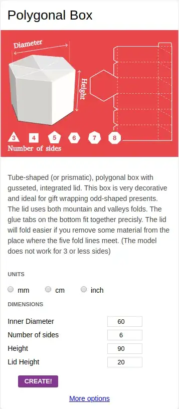

You can design all of the cuts, folds, joining tabs, etc., yourself, and then use tools like what are described in the other answers to create a clean layout. An alternative is to start with the finished shape you want, and then use software that figures out how to create it from 2D stock. There are a number of such applications.
  • If your needs are reasonably basic, there are free online template makers like Template Maker. They have libraries of basic and not-so-basic shapes and objects. You customize the design. Here's a sample object to give you the idea:
    The "More options" screen:

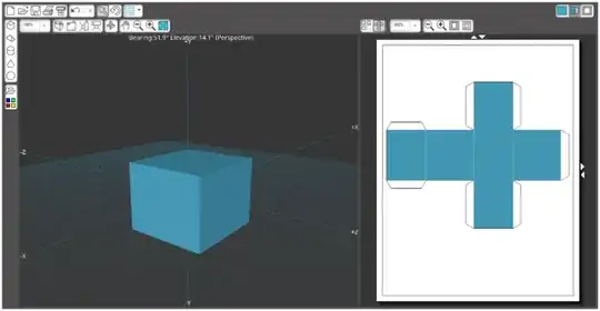

  • Silhouette ModelMaker is $50 software from the makers of the Silhouette cutting tools (it doesn't need to be used with those tools). You design a 3D model from basic shapes. The software figures out how to create it from a 2D pattern, including the joining tabs. There's a good overview of it here.
