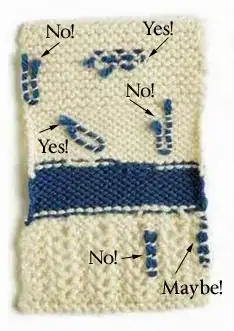

How to weave in
Thread the yarn end on a yarn/tapestry needle, on the back of the work mimic the stitches of your fabric (for stocking stitch fabric) or thread it up and down knit stitches (for ribbed fabric). For a short end work just a few stitches this way
The upper part of this illustration shows how to do it in stocking fabric and lower part's 'no' would work well with ribbed fabric.
