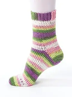

Most amigurumi patterns are worked in the round, not flat. For flat items the difference between regular and back loop only (blo) crochet stitches is striking, it creates horizontal ridges, which are often used to imitate ribbing, like in this sock:
sample from New Methods for Crochet Socks

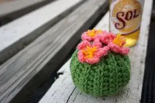

While amigurumi often use single crochets, when you want a ribbed texture, like with this cactus project (requires Ravelry account), you need something different.
Amigurumi Cactus
(Pattern here)
This stitch is an easy way to achieve it.
