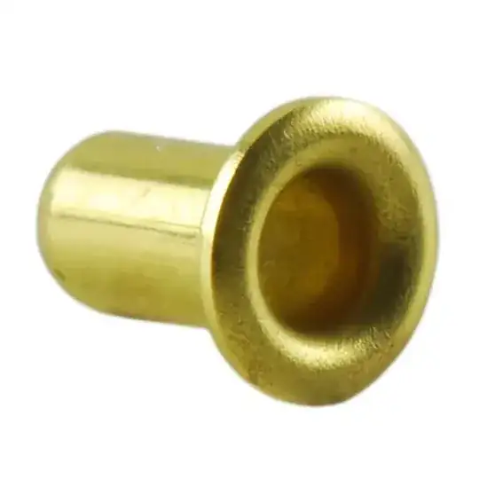

Small brass eyelets could be quite durable in this application.
These are sold for card-making and scrapbooking and used to appear on certain kinds of office supplies in very similar applications. They might also be sold at leather crafting outlets.
They would require a hole be punched in the cardboard first, for best wear characteristics. Also, how far you set them is critical to getting the right resistance to rotation of the two cardboard pieces.
Their use requires a punch and die that would be sold at the same place for a few dollars. It's possible there is a pliers-like version as well.

    These are actually used for the purpose in some cardboard toys, fancy greetings cards, etc. I suspect you'll need to experiment with the amount of pressure you apply to close them, or use a spacer to keep some slack in the joint. Ideally the punched hole should be a close but not tight fit – Chris H Feb 05 '18 at 09:03
