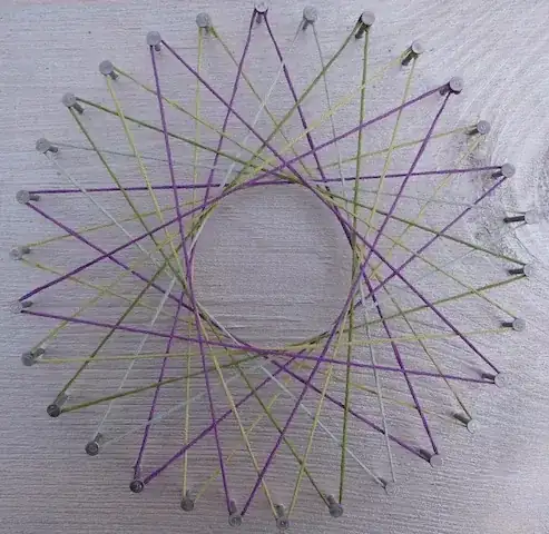

But if you want to learn the craft/art, you should start with simple patterns, like this one below, (specially done in different colours here to make it easier to follow).
Generally, you plan out your pattern on paper, to figure out where to put the nails in the board. You then place the nails, tie the end of the string to your starting point, and start stretching the string from nail to nail, wrapping around the outside and continuing to the next nail in the pattern.
Contrary to some of the answers elswhere, you generally use only one string, unless you want different colours.
