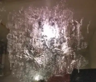

Napkin snowflake
Napking snowflake
Picture taken after solution was applied
So I wanted to try something that would hold liquid and not tear easily after it was cut. Most common napkins are frail so I used a heavier duty one. Any absorbent cloth would work but napkins are easier to come by.
Napkin on window
Tried to keep my face and dirty kitchen out of the picture. You don't need more detail to know it looks awful
This didn't turn out quite good at all. It was hard to get the right amount of liquid applied and keep the detail. Only my first attempt mind you. Read onto sponge for and improved version of what I was trying for here.
