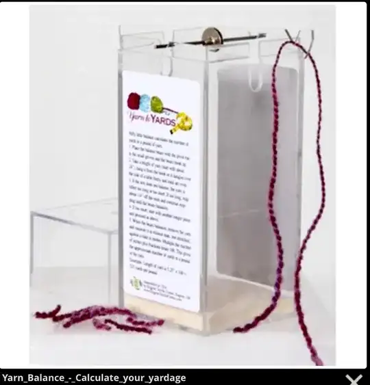

So, if while figuring out available yardage for a mystery yarn, you need a more exact yarn weight answer, there is one other option: a "Yarn Balance". This brilliant little tool can very accurately tell you the number of yards per pound of yarn, using a sample of the yarn several inches long. The link above has an excellent photo tutorial. (Photo from The Woolery:)
