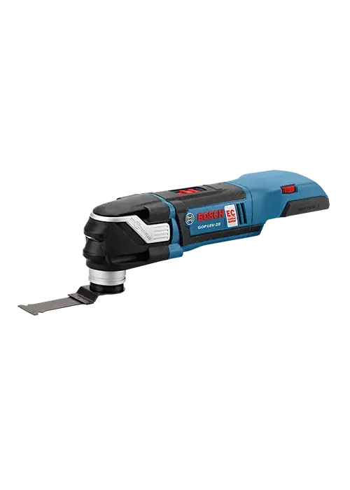

Last on the list would be an oscillating cutter.
oscillating cutter
Many manufacturers, corded and cordless, with multiple tool selections. No kerf adjustment, generally speaking, more easily controlled than a circular cutter but slower.
