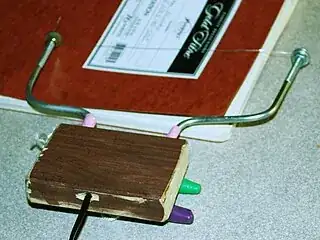

Yes, it's called "hot-wire (foam) cutter" which can be bought starting at prices of about $20, or you can also make one yourself.
foam cutter
The hot wire melts the Styrofoam, releasing toxic fumes (styrene), so it's best to use it in a well-aerated room or outside. (See e.g. this link for more safety advice.)
It will work on Styrofoam, but probably not very well on soft foams.

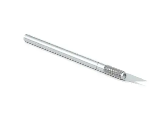

An X-Acto knife is probably going to be your best bet for the least cleanup of loose Styrofoam. Cut firmly but not so deep as to tear the Styrofoam. Basically just the tip each pass and make multiple passes. It will be slow and tedious, but if you do it right, it won't be messy.
