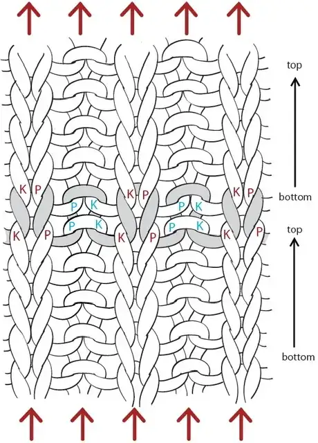

(Adding here The Answer that the OP identified in Comments as The Ultimate Solution to her dilemma...)
Based on the link provided by OP @Tara-Hanratty, Grafting Knitting, Myth 2: Grafted Ribbing Will Always Have a Half-Stitch Jog, here is the answer:
The author, Joni Coniglio, explains that the half-stitch jog in grafted ribbing is not actually unavoidable, as many knitters apparently believe. Knitting direction, not merely knitting stitch choice, turns out to be the main factor in whether a half-stitch jog will appear in grafted ribbing. In some well-smithed word craft, accompanied by beautifully clear and understandable visuals, Ms. Coniglio deftly explains the very complex and nuanced behavior of top-to-top oriented grafting, which will create the dreaded half-stitch jog every time. I am not shameless enough to cut and paste her eloquent verbiage here, nor am I capable of adequately paraphrasing something so akin to brain surgery. The link will have to suffice.
More to the point of Hanratty’s specific question, Coniglio goes on to share the happy news that top-to-bottom oriented grafting does not produce the half-stitch jog:
In top-to-bottom grafting, the direction of knitting on the front needle moves toward the grafted row while the direction of knitting on the back needle moves away from it. Thus, the direction of knitting continues uninterrupted from the piece on the front needle through the grafted row to the piece on the back needle.
Therefore, Hanratty may proceed to whack off the offending and unmasculine bell-shaped bottom of the project, and graft a ribbed bottom section onto it in the top-to-bottom grafting procedure outined by Coniglio, resting assured that a half-stitch jog will not appear.
Further complex and amazing instructions are provided in the article for Picking Up a Provisional Cast On, and Written Instructions for Grafting k1, p1 Ribbing Top-to-Top and Top-to-Bottom. Links to four video tutorials on all of these topics reside at the bottom of the page. Surely this Joni Coniglio must be The World’s Foremost Expert on Knitted Grafting!
