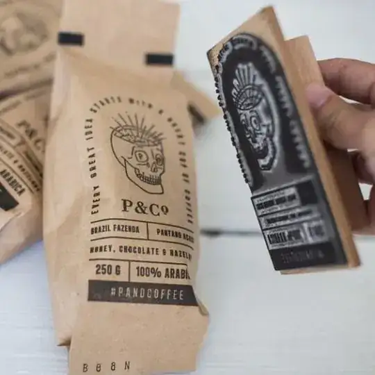

I was just browsing in Pinterest and I found this: https://www.pinterest.com/pin/454511787378322393/ and If you can't see it, I'll upload the image here:
Now, my question is: what is that? is it possible to make one of those that prints the brand in the papel craft? Thanks!

    You seem to know that it's a stamp. So, is your question on how to make your own customized stamp? –  Oct 18 '16 at 03:19
  • @Matt that answer my question! thanks! I got a little business with bags like that and I wanna have a really good quality. Guess I'll have to pay for the stamp and get really good ink. – gglasses Oct 18 '16 at 03:54
Simply put, that is a rubber stamp. That particular one appears to be professionally machine-made given the fine detail in the rendered image e.g. lines in the skull and the typography this would be expected.
That does not mean you are forced to have one made. You can get very good results making your own. Although I doubt you could make the one you pictured without specifically designed machining tools.
There are many options for this as well. A very simple one would be to cut a stamp from a potato. You only need a potato, ink/paint and a knife for the some simple like a star. If you are curious this YouTube video would be a good primer. It even shows using cookie cutters to get more precise shapes.
A realistic option that is more in line with what you show in your question would be to carve your own rubber stamp. Lots of tutorials out there for this one as well. I found this one from dearhandmadelife.com to be well written and full of useful pictures of the process. I will provide a basic outline of the process here.

Use the paper and pencil to draw what you want the stamp to actually look like. No need to draw it mirrored or anything. Just exactly how you want it to appear. Fill in any space that you want to be stamped. White or blank areas will become the negative space of the stamp.
The graphite from the pencil should transfer easily to the carving rubber. After that it is just a matter of carving out the blank areas in your rubber deep enough to prevent ink from adhering to it during the stamping process. You will also need to carve away an area outside the stamp as well for the same reason.
If you wanted to mount it then cut off any excess rubber and glue it to the block. Stamp all the things!
Your choice of ink will depend on your applied medium. Experiment. Standard ink pads should do the trick though. Depending on your product and placement you may need to worry about things like UV and the like.
