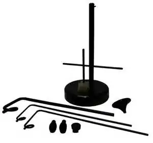

The other problem could be the thread holder, are you using a spool or cone? How is it attached or docked to your machine or the table?
spool adapter image If it is a spool that is loaded sideways, the thread might be getting caught in the spool's edges and you just need the slide on piece (spool cap) that holds the spool in place. This may also help on a vertical holder.
spool cap
If you are using a cone, check to see if the thread is not releasing, sometimes it can get caught up underneath. You may want to get a spool holder and mount it to your table near the back of the machine.
cone holder
