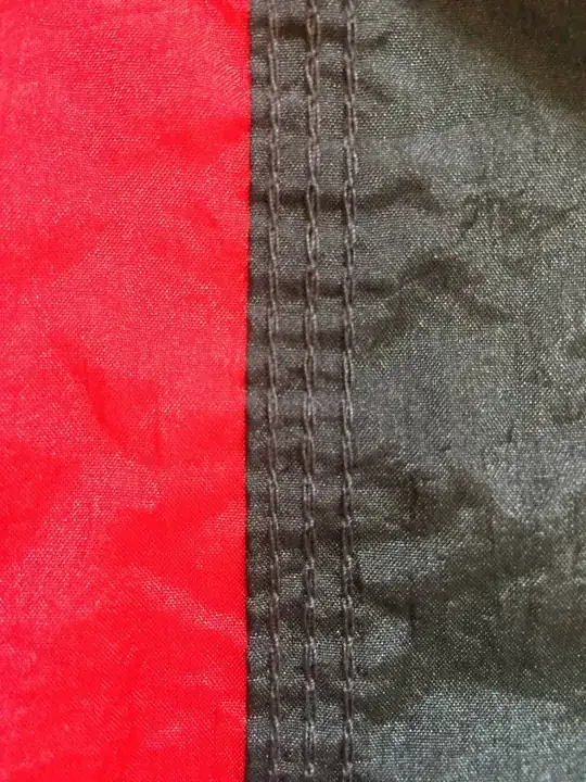

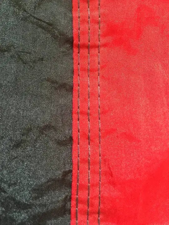

I'm looking at the stitching on my hammock, wondering what kind of stitch it is and how to do it myself.
I see this marketed as a "triple interlocking stitch." But searching on Google only brings up marketing materials for hammocks. I cannot find info on how to actually sew it.
Here are pictures of the frontside and backside of the stitch.
frontside of triple interlocking stitch
backside of triple interlocking stitch

  • I have no clue (really) but if I had to guess, it's done on a single, specialized sewing machine that puts in all three rows of stitching at the same time... probably some sort of serger. – Catija Aug 12 '16 at 19:25
  • So the real question might be, "What is a single interlocking stitch?" – Ast Pace Aug 12 '16 at 21:08
  • My guess is that the edges are not sewn, but in fact are folded in and sewn with three rows of stretch stitches which are employed both for strength, elasticity and eliminating puckering. Are the edges folded in? – Ken Graham Aug 14 '16 at 02:11
  • @KenGraham It looks as if they are two materials on top of each other. – Zizouz212 Aug 14 '16 at 03:31
That was made by a triple needle chain stitch machine. You can tell it was done in one pass with a triple needle machine because the holes align perfectly along the length of the stitch (making it very likely they were all formed at the same time).
You can tell it's a chain stitch (as opposed to a lock stitch, which a typical household sewing machine makes) by the way the stitches are formed on the back. Another common place to see chain stitches in your house is on jeans.
The main advantage of chain stitching (and the reason it is used in commercial applications like this) is that it doesn't require a bobbin. A home sewing machine is a lock stitch machine, which means the top thread is twisted around a bottom thread by passing over the bobbin on each stitch. The bobbin is limited in size because the top thread has to go around it. A chain stitch machine can sew much longer without interruption.
In particular, I think I see three threads on the back, which is a double chain stitch. Those extra threads don't actually add any strength. More the opposite -- chain stitches can easily be unraveled if the thread breaks, just like pulling apart a row of knitting.
If you want to recreate that seam, just sew three times with your home machine on straight stitch. You won't be able to recreate the stitch length (your home machine just won't make stitches that long), which will cause a bit of extra puckering (shortening along the seam).
By far more important than exactly what stitch you use is to use a good bonded polyester thread or an outdoor item like a hammock will fall apart when the thread rots.
(If you want to see an industrial machine that could do this, Google something like "triple needle six thread chain stitch". Six threads because it's a double chain stitch.)
