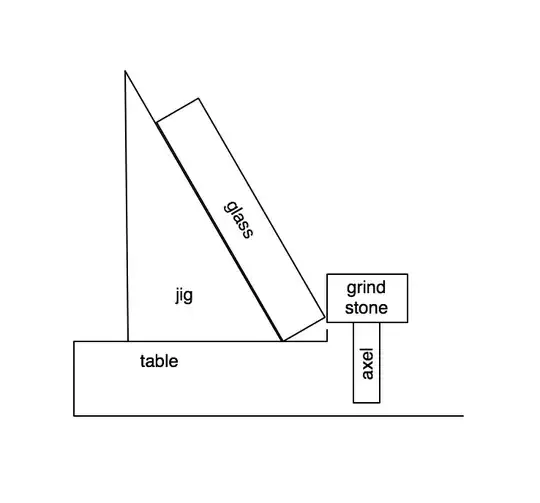

By the sounds of your application, a table-top glass grinder is the right answer. I'm saying this from a couple assumptions:
  • It sounds like you're making many of these and just want a nice edge to your mirrored glass.
  • You probably want minimal effort to accomplish this, for now.
  • You have not described the need to artistically embellish the edge of the mirror / glass plates.
Many of the dremel-related answers address the issue that you may begin to decorate the edges in an artistic manner. If that's something you'll plan on, then a table-top grinder is probably inappropriate because it serves mostly two purposes:
  1. to grind cuts smooth
  2. to round edges and make meager, coarse, bevels
If you'll only need to do one of the two above, then the glass table grinder is fine. However, you will need a jig if you want to grind regular angles.
A jig is basically a sloped block that will hold the glass at the angle you want to grind the smooth angle. See below. You can create a few of them for the common angles you'll work.
In case it's not obvious: the jig is generally a 'free' block and isn't mounted to the table. It can be mounted, if that's more convenient because you basically have one type of cut that you ever do.
Many times, a table will have a couple holes drilled in them, for the jig to mount into via pegs. How to handle jigs is probably another question altogether.
jig diagram
