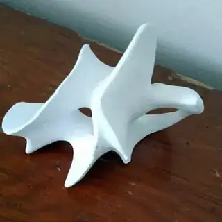

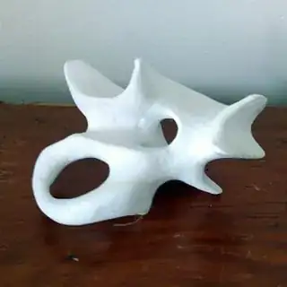

In school, I once made a subtractive sculpture from a plaster block. Actually, the block was in the shape of the large yogurt container it set up in (about 4 inches in diameter at the top, at least 4 inches tall).
I used knives and files to slowly make an abstract sculpture that I really loved, but the preparation for the plaster was done completely by the instructor.
I did some searching on plaster, but the mixing information was generally about creating plaster to put on something else to create a mold. It wasn't about simply creating a piece to carve from. I'm not sure of search terms to use to narrow it down.
Should I just mix the entire thing in the container I want to use for the block shape? Do I mix it in a larger container and then pour it into the final one? Do I add less water since I won't be pouring it over an object?
Here's an example of what I'd like to be able to do again. Although my block started quite large, I made this quite small piece:

  • Wow, that's a really nice piece! – Rand al'Thor Jun 05 '16 at 19:30
  • @Randal'Thor It's a little roughed up from being in boxes for moves, but it was so much fun to make (and so messy), and it's so smooth and just fun to turn around in your hands and see where the curves lead you. –  Jun 05 '16 at 19:32
