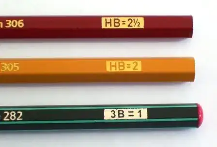

Pencils seem to have different types:
From what I've seen, there's a few types:
  • HB
  • 2HB
  • B
and so on.
What's the difference between all the different pencils? When do I use one or the other?

A "number 2 pencil" as we (in the US) are often told to use for filling out multiple choice answers on Scantron sheets, is right in the middle, the equivalent of "HB"... though, according to this site, there's no "industry standard" so one company's HB may not be the same as another's. This is also explained in the Wikipedia article linked above, which notes that on some scales, the US equivalent of HB is a #2 pencil, while other manufacturers use the equivalent HB=2½.

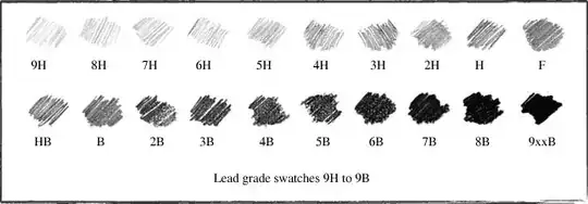

As a general explanation of the differences between the grades, pencils.com shows the following image:
Lead hardness/softness
As you can see in the image, the higher the H value, the lighter the result but the finer the point, while at the other end, the higher the B value, the darker the blackness of the graphite and wider the point.
This site has some great guidance on what the benefits of each are:
H leads are extremely smudge-resistant and give cleaner lines, making them useful for things such as outlines, technical drawings, light sketches, and even watercolors. Left-handed pencil users can also take advantage of smudge-resistant H leads. On the downside, hard leads tend to be scratchy, especially as you move up the scale.
B leads are smooth to write and draw with. They smudge easily, but are readily erased. They're perfect for pencil drawings as artists can take advantage of the brush-like expressions, especially in the higher B grades. Animators in particular enjoy using 10B over animator paper because it writes like butter, creating nice, quick, heavy lines with no friction.

  • But what's the difference between "HB=2" and "HB=2.5" as shown in the OP's image? How come there's more than one kind of HB? – Rand al'Thor May 21 '16 at 21:25
  • @Randal'Thor No clue. The numbers may not even relate to HB... they could be the width of the graphite inside the pencil, for example... I can't see the brand so I don't have a way of doing any additional research... but that's not what the question was asking about. The content of the question only relates to the H or HB or B parts. – Catija May 21 '16 at 22:24
  • Looks like it relates to there being more than one system for classifying the pencil's grade and the note above that not all HB pencils are equal to each other... One system has HB=2 and the other system has HB=2.5 where HB is a Worldwide rating and the 2 or 2.5 is a US-specific system that is where we get the "use a #2 pencil on this test"... https://en.wikipedia.org/wiki/Pencil#Grading_and_classification – Catija May 21 '16 at 22:32

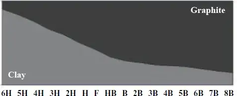

The following image is adapted from product information for the Castell 9000, which is available in 16 degrees of hardness:
degrees of hardness
The same scale of hardness is used in ISO standards (for example for the determination of film hardness of paints by pencil test; in this test method, calibrated pencils of known hardness are pushed over the film). The hardness scale in use in the United States employs only numbers. The most important grades in the two scales approximately have the following relationship:
  • 3B – 1
  • 2B – 1 1/2
  • B – 2
  • HB – 2 1/2
  • F – 3
  • H – 3 1/2
  • 2H – 4
  • 3H – 4 1/2
  • 4H – 5
