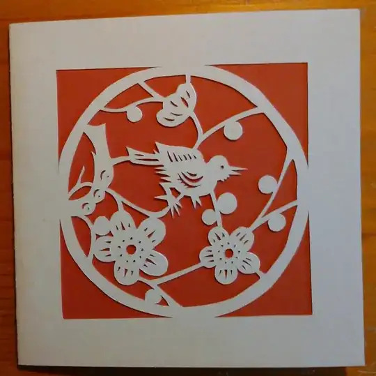

When papercutting, one often has to cut very small circles, like below. When I do that, I often break my blade. How should I cut small circles or other small holes? Think about ...
  • Should I apply pressure or not?
  • Should I only turn the knife on its place or really move it?
  • Should I hold the knife vertically or diagonally on the paper?

    Which of the circles are you asking about? The center of the flowers or the ring around the center of the flowers? Could you give us a more concrete measurement of "very small"? – Catija Apr 26 '16 at 21:43
  • @Catija you are right, this should have been more clear. I meant anything inside the flowers or the bird -- that is, up to 2mm diameter or so. – Keelan Apr 26 '16 at 22:29

Punch it
Given the size of the holes you are doing this might not seem like useful advice but I would bet that this is what the artist in the picture did, as those are not perfect circles. Outside of this you could use a small punch to get a perfect circle.
small punches
The way you get that to work is put a lot of paper (or some other thick material) underneath so that the "work" paper will be less likely to tear out.

    Why would you try to punch half a hole and potentially end up with an odd figure 8 shape or an ellipse if you don't center it perfectly. The example art seems to show plenty of space to fit the entire hole punch without folding (which would leave creases in the paper). – Catija Apr 26 '16 at 21:42
