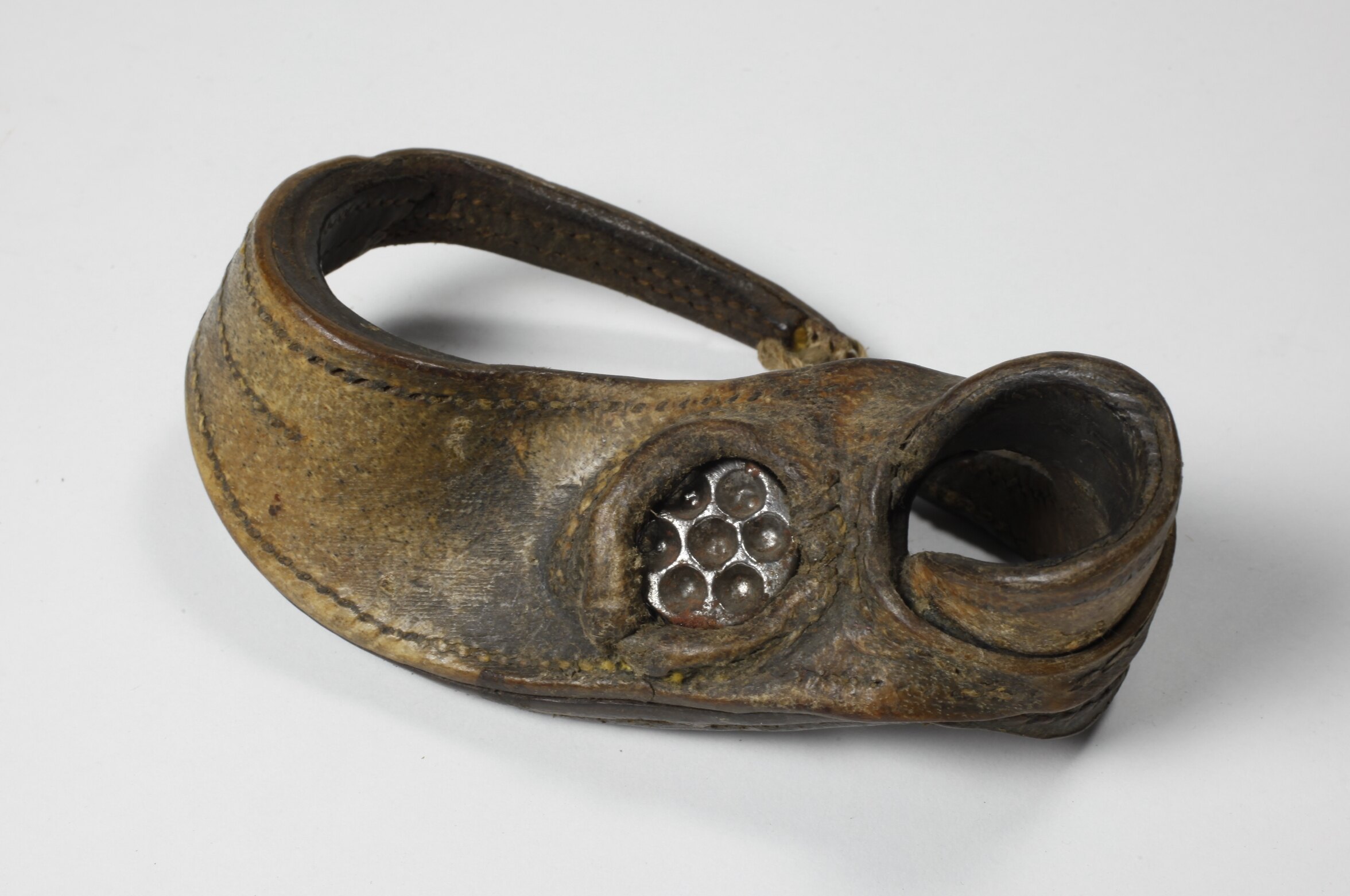

  • The roping palm is used for heavier work such as sewing boltrope to the sail. The indentations in the eye are fewer and larger to accept the end of the larger needles that are required for heavier work [see e.g. this image]. Leather extends up the thumb of the roping palm. This allows the user to wrap the thread around the thumb for greater pull without cutting into flesh.
An important difference in the designs is that some have the 'thimble' in the middle of the palm, whereas others have them against the thenar eminence. One probably has an advantage over the other depending on the task and personal preference, but for heavier duty work (like roping) the one closer to the palm might be better, as the needle will be more in line with the arm, and more force can be applied.
I think most if not all differences in design are matters of preference, as well. One that stands out is that some palms are single strips of leather with a hole in them, while others consists of two distinct strips, of which one is strapped around the thumb (and some DIY designs are Y-shaped).
I can also imagine that historically different countries or regions had design differences—the one sold here is called "Dutch", for example.
