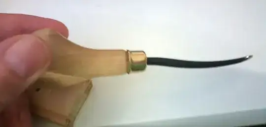

I'd suggest an U-shaped carving tool. V-shaped is harder to work with.
Here is 2 mm U-shaped carving tool and grooves it makes. This one costed me ca. 10$. It is also useful thing in household.
