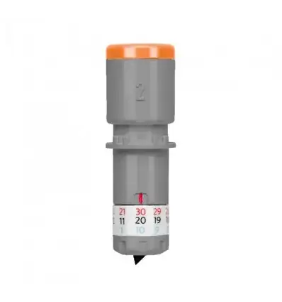

The blade tools of the Cameo (and other plotters / cutters) looks like this:
The blade itself is centered, but the point of the blade (where the actual cut is made) is not. That means, when the tool changes directions, the blade tip still follows the old direction for a few millimeters until it gets dragged into the center of the path. In addition to that the material you cut (fabric backed vinyl) may stretch and bunch up in front of the blade, increasing the inaccuracy even more.
Looking very closely at your sample, we see that one corner of each triangle is very pointy and the opposite one is rather rounded:
My suspicion is that the cutting tool moved clockwise when cutting one of the triangles and counter-clockwise when cutting the other one. That means that the little distance between the cutting point and the actual center of the path is applied twice in your case (outer triangle too much to the left, inner triangle too much to the right) and becomes too obvious.
The way around this is to plan for the tools inaccuracy in your design. Deliberately move the inner triangle to the left by the measured distance in your finished cuts.
