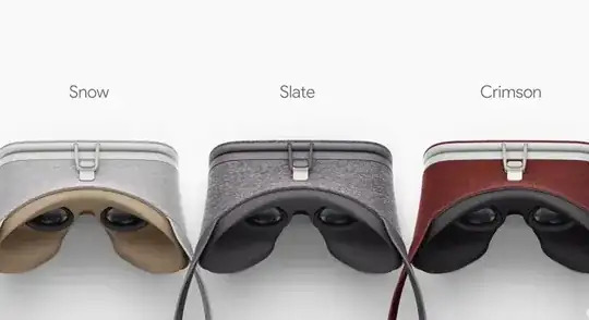

For a kiosk that I am building for a small public library, I am considering options for how to decorate it. The library's palette is rather weird, and I am unable to think of a suitable solid color.
However, I think a fabric finish would look and feel very nice. Inspired by products such as the following:
Fabric covered VR headset from google (Source)
Fabric covered speaker (Source)
My concern is with wear, cleaning, and durability. I intend for this kiosk to last 5-8 years, and the materials will be touched by users' hands but not sat on. Do you have experience with such a project? What should I watch out for?
