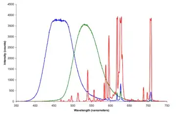

Here are the wavelength spectra of primaries from particular CRT, AMOLED, and LED-backlit LCD displays:
None of these violate the sRGB standard, as long as they result in the same tristimulus values (up to overall brightness). This is something that fixer1234's answer basically gets right, except that it's couched in the idea that RGB is the brain's internal color space, which is wrong. What matters is only that the internal color space is three dimensional, while wavelength space has a much higher dimension (theoretically infinite), and as a result you have a huge freedom in choosing wavelength spectra that will map down to the same 3D point.

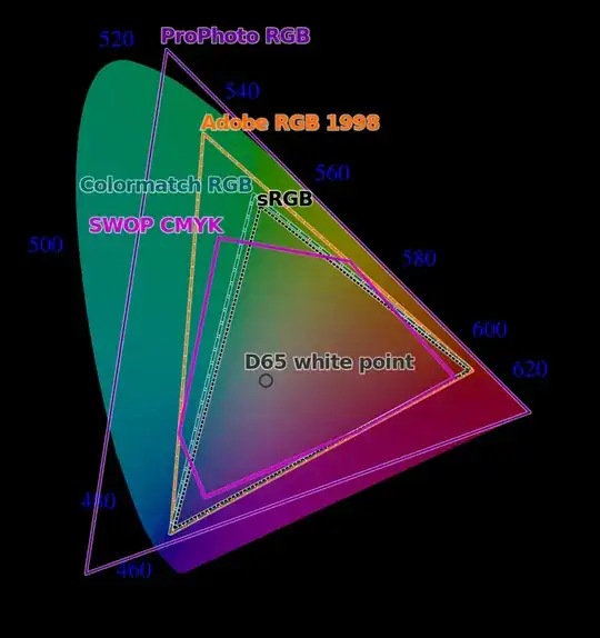

If you pick specific values for Red, Green, and Blue you define an Absolute color space https://en.wikipedia.org/wiki/Color_space#Absolute_color_space
If you look at this chart of various RGB color spaces there's quite a few choices. https://en.wikipedia.org/wiki/RGB_color_spaces
It should also be possible to intuitively see why a triangle made of different colors than Red, Green, and Blue would be inefficient and leave out colors that we can see.
different RGB color spaces
Note that even the bigger RGB color spaces do not capture everything.
