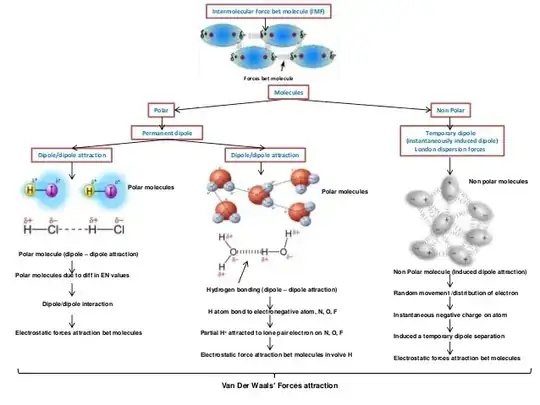

To answer you question, we have to take it from a scientific point of view. Its been a while since I did A level chemistry but i think i know enough to give you a simple enough answer. The atoms of hydrogen and oxygen in water, as well as hydrogen and carbon (and other elements which will form the plastic, while hydrogen and carbon are the main ones) give out intermolecular forces- van der waal/dipole dipole forces, hydrogen bond (still a force, but a strong one of that) and temporary dipole forces. They occur due to the attraction between atoms, which will all have different arrangements of their electron shells, number of protons and number of neutrons. Hence different atoms have different levels of attraction. Secondly, static also builds up on plastics when put under energy, thermal in this case, so the water is attracting to the plastic in clumps. You can test this with a balloon rubbed over the carpet, then run under the tap. some water will remain.
To conclude, The plastic and water are just attracting to each other, by intermolecular forces as well as static forces. Think of it like the static collects at several particular points, then the intermolecular forces also help to keep it together.
