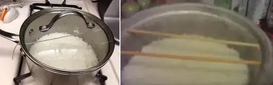

How to keep a rice cooker from boiling over https://www.youtube.com/watch?v=NsRmzEy8Kdk or keep a wet paper towel over the vent or place a wooden stick or string of rope across the container enter image description here
