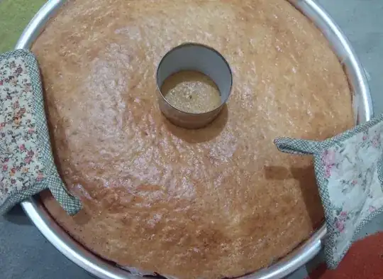

So, here's is what I did:
I did calculate the volume of the cake pan I wanted to use (37 x 5 cm) and the one the recipe calls for (23 x 4 cm), thanks to @Stephie's answer. From the ratio, I figured how much batter is needed to fill the 37 cm cake pan. As for the baking of the large cake, I did take @Joe's advice, used an old towel and a tin can opened from both sides in place of flower nail. The other point @Joe mentioned was longer baking time in lower temperature, I usually bake the cake of the original recipe for 35 minutes in 180 C so I reduced the temperature to 150 and baked the large cake for 50-55 minutes. It turned out just like the small cakes. enter image description here
