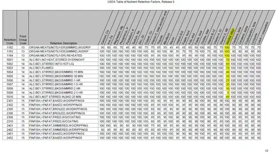

61
A study conducted by the US Department of Agriculture’s Nutrient Data Laboratory calculated the percentage of alcohol remaining in a dish based on various cooking methods. The results are as follows:
Preparation Method and Percent of Alcohol Retained
  • alcohol added to boiling liquid & removed from heat: 85%
  • alcohol flamed: 75%
  • no heat, stored overnight: 70%
  • baked, 25 minutes, alcohol not stirred into mixture: 45%
  • baked/simmered, alcohol stirred into mixture:
    • 15 minutes - 40%
    • 30 minutes - 35%
    • 1 hour - 25%
    • 1.5 hours - 20%
    • 2 hours - 10%
    • 2.5 hours - 5%
These data come from the USDA Table of Nutrient Retention Factors Release 6 [PDF]. The information is in the table on page 12 of the document (page 14 of the PDF file). In case that link goes dead (sorry that the screenshot is somewhat small).

  • Link to stats you posted? – But I'm Not A Wrapper Class Dec 29 '15 at 18:25
    @CyberneticTwerkGuruOrc The source is USDA Table of Nutrient Retention Factors Release 6 [PDF]. See p14, for example. Alcohol is listed near the right-hand side of the table. – Michael A Dec 30 '15 at 23:01
    This answer currently misrepresents the source in a way that may mislead readers. The retention factor is not a true "percentage of alcohol retained" but is normalized against the mass of the dish, a value that changes as it is cooked and moisture (including but not limited to alcohol) evaporates. Since the mass of the dish decreases, the actual "percentage of alcohol retained" is lower than the retention factor implies. – Air Jan 29 '18 at 18:43
    Strangely, this chart omits any methods that involve constant boiling. That method would remove most of the alcohol; that's how liquor is distilled. Or perhaps not strangely, as there's no point reporting instances where negligible alcohol is retained. – Ray Butterworth Jan 02 '20 at 16:47

It is important to note that the table accompanying the USDA Table of Nutrient Retention Factors Release 6 December 2007 lists a amazing number of foods--all have 100% Ethanol retention levels for the listed food item and cooking method.
Only ALC Beverages listed and simmered as described on page 12 of the table (items with Retention Codes 5001 through 5010) have the decreasing retention percentages listed by BobMcGee and merl.
I had long assumed sufficient heat of sautéing, frying or baking removed most if not all ethanol. I am astonished to discover otherwise.
    Only the items with retention codes 5001 through 5010 have any significant alcohol at all. 100% of 0 is 0. http://www.ars.usda.gov/SP2UserFiles/Place/80400525/Data/retn/retn06.pdf – Jolenealaska Jan 04 '15 at 10:01
