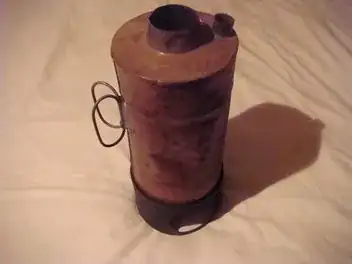

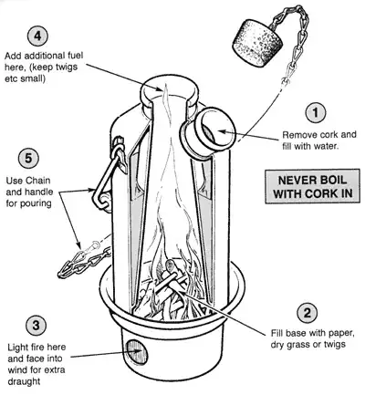

You need a Thermette (Kelly Kettle or Storm Kettle in North America - they're all brand names). This would match the vintage theme.
Larger ones have taps near the base, and can boil 10 cups of tea in a few minutes.
These were coveted by construction and rail road worker gangs, as they could have a 10 minute break for a cup of tea and a biscuit (cookie in North America), including the time to boil the water.
Thermete
Storm Kettle
TFD
  • 25,223
  • 49
  • 90
  • Good idea - basically the same principle as a samovar or the camping water boiler mentioned at the other answer. Seems they are stil available today. Putting one on my "wishlist of cooking tools"... Safety precautions regarding open fire remain. – Stephie Jul 08 '15 at 06:33
  • Information only: Water heating takes about 1.1 kWh per 1000 litre-degrees. To heat water from say 20C to 100C = 80C and 10 cups is about 2.5 litres so you want 80*2.5 = 200 litre degrees or about 1.1/5 = 0.22 kWh. To do this is 10 minutes = 1/6th of an hour you need 6 x 0.22 = 1320 Watts. Say about 1500 Watts to allow for some losses or 2000 Watts to give you a bit of time to drink the tea before tea break is over. That's a large stove element or 2 bar heater type heat supply. Definitely doable with a Thermette but a right roaring blaze will be needed :-). – Russell McMahon Jul 08 '15 at 12:19
  • @Russell McMahon Theremete by design burn with a roaring blaze, a bunch of twigs are reduced to ash in a minute, I would estimate a large sized Theremete would be burning around the 5Kw mark (based on comparing flame and heat from our 20Kw house fire box) – TFD Jul 09 '15 at 08:01
  • @TFD Yes - they can be enthusiastic. I used them "in anger" long ago when accompanying line gangs during vacation work periods while at unversity (long long ... ago :-).) | Hydrocarbons are good for around 10 kWh/kg and I'd estimate wood with some water content and other than just CH bonds as say 5 kWh/kg. 25% efficiency chemical to thermal into water is probably high. Maybe not. 5 kWh/kg x 25% = say 1.25 kWh/kg. We need 0.22 kWh here so 0.22/1.25 ~= 0.2 kg of wood. That sounds very achievable and lower than I'd have expected. I have a thermette here somewhere - must dig it out and play :-) – Russell McMahon Jul 09 '15 at 08:36

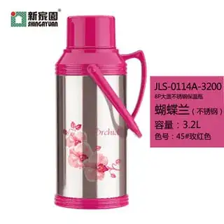

Use a Vacuum Flask
An every-day thermos is not big enough for this task, but food service professionals have provided hot coffee and tea with larger purpose built containers.
Background
In China boiling water is often put in large (maybe about 3 liters) vacuum flasks. These are used at tea conventions, on trains, and at roadside stops. The water stays very hot and makes fine tea and instant noodles.
Selection
The following images show a couple of the smaller containers suitable for this task. Each of these are about the same capacity. The one on the right is similar to coffee dispensers at bagel or breakfast shops. It has a lever that can dispense the liquid inside.
Large 3.2 liter flask 1 gallon hot drink dispenser
