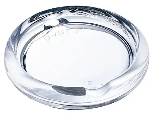

There is a device you can buy, known (here in the UK, at least) as a milk saver
It comes in glass, ceramic or metal.. I'm sure you could improvise your own if you can't find one. All it is, is a disk about 8cm in diameter, with a recess to collect small bubbles, and a vent on one side of the rim about 1/2 the depth of the recess, to release the accumulated vapor as one large bubble. The one in the illustration repeats the pattern on both sides, so it doesn't matter which way up it is, or if it flips.
It prevents foaming, breaks skin formation, and when the liquid is near boiling, it rattles in the pan, serving as an alarm.
Robin Betts
  • 1,895
    It's designed to work in a pan on a stove. I've seen a lot of ashtrays, for example, which have similar features... it wouldn't surprise me if you could get hold of one of those, in stainless steel, or something like it, which is heat and food safe.. – Robin Betts Oct 22 '18 at 10:17
    In a pinch, a saucer or metal jam jar lid works as a substitute. Just place it so that steam can collect underneath and make it rattle. – Stephie Oct 22 '18 at 13:51
