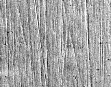

This is the microstructure of SAE 304, a steel type commonly used in pans:
At this magnification, its "pores" look like cracks. Now see it at other magnifications (still a SAE 304, other types of steel look completely different, especially if you look at martenistic steels):
It gets even more complicated than that, because steel structure differs between the surface and below the surface:
As you can see, the holes are nowhere "pore" shaped. But they exist; steel is not even at the microscopic level.
I cannot point you to more cooking-relevant sources, but this at least confirms that holes exist in the type of steel used for pans. Somebody else will have to tell us what happens to them when heated.

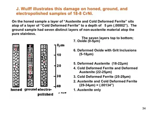

    J. Wulff obviously is not a metallurgist. Stainless steel grade 18/8 is completely austenitic, a ferrite (iron) layer does not exist. Deformation is caused by cold working. If the stainless is overheated the carbon may diffuse into the grain boundaries, this can cause galvanic corrosion. This results in stainless that can rust unless the stainless steel is solution heat treated. –  Apr 21 '16 at 12:18
  • @user45215 - that's not very generous. I did some digging and J. Wulff is likely John Wulff. If that's correct, he was an MIT metallurgist. His heyday was the 50's, so perhaps this is now out of date. https://academictree.org/physics/peopleinfo.php?pid=64588 – DeusXMachina Jun 27 '21 at 13:39
  • @blacksmith37 indeed, that was the point I was trying to convey. The initial claim is that steel has pores, but when one looks at its surface structure, the unevenness is not really compatible with the idea of "pores". – rumtscho Mar 16 '22 at 18:13

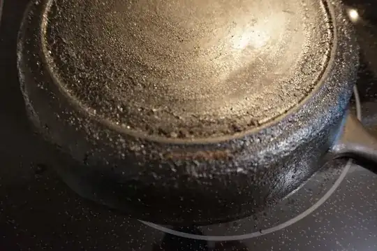

I am retired but for this purpose I'm putting my machinist's hat on temporarily. I have machined a lot of cast iron in my day and when it is machined the cuttings that come off of the part break up into small pieces as compared to how steel cuts giving off cuttings of a wiry or curled nature. The nature of cast iron and the way it cuts in the machine shop leads me to believe that it is porous throughout.
I use my cast iron frying pan a lot and keep it seasoned. When I clean it I simply rinse it out, fill it with hot water and a light scrubbing with a copper scrubbing pad and a final rinse...no soap. The next time I use it I heat it up and put either margarine or olive oil in it and spread it around the bottom of the pan with a paper towel. That brings back my non-stick surface.
Back to the porosity, it is my contention that the porosity allows a certain amount of the oil to completely penetrate the frying pan from the inside to the outside. Evidenced is the black crust buildup on the outside of the pan. I am very careful about spillage when I'm cooking and when I'm cleaning the pan I'm careful about the runoff from the pan so I don't believe that the crust is accumulating on the outside from something that I'm doing. It seems to me that the oil is going through the pan by way of the porous nature of the cast iron.
Inside of the pan
Outside of the pan showing black crust buildup
