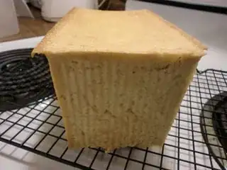

Typically a loaf loaf looks like this, I made this loaf a few weeks ago:

Over half the times I have made this recipe (including yesterday), I've used my bread maker to knead the dough. I always use my (spookily accurate) digital scale to measure the ingredients; I put the bread maker insert or bowl on the scale and tare between ingredients. I always bake in the same Pain de Mie pan. Up until yesterday it has always taken 1 hour for the first rise and a half an hour for the second. I preheat the oven during the second rise, I bake for 25 minutes (per digital timer), covered, then 5 more minutes uncovered. It's as routine as brushing my teeth.
Yesterday I noticed the dough was a bit sticky when I put it into the pan after the first rise, and the first rise was done a bit quicker than usual, maybe 45-50 minutes instead of an hour. The second rise took 25 minutes instead of the usual 30.
But this is where it got really weird. The dough just went nuts in the oven. It oozed into the lips of the pan lid and onto the oven floor. You can see the shape of the loaf is odd because the dough was squeezing into the crannies.

I would just blow it off, chalk it up to human error, and assume that my next loaf will be normal. But, this bread was the best loaf of this type that I've ever made, so I want to figure out what I did wrong so I can do it again :)

Jolenealaska
  • 58,494
  • 204
  • 324
    Judging by the extreme expansion I'd investigate the yeast. A flimsy theory but maybe helps your experimentation? – MickLH Jun 20 '14 at 20:48
  • @MickLH I know the yeast is good, but I certainly could have used too much. I've been using the same 1lb pack for months. I keep it in the freezer. – Jolenealaska Jun 20 '14 at 20:50
  • Salt does inhibit the yeast, but it wouldn't make it more gooey. Also, I can't imagine bread with 1/3 the expected salt being described as good... Also, normally upping the amount of yeast hurts flavor. So I doubt it was mismeasuring the salt or yeast. Honestly, despite protests, I'd go with you added more butter or honey. – derobert Jun 20 '14 at 20:51
  • Now you guys know why I am puzzled! :) – Jolenealaska Jun 20 '14 at 20:52
    Due to the rising time difference, I wonder if perhaps the yeast was a bit too high and perhaps the dough was a bit warmer than usual? The combination could lead to the dough being softer and stickier – SourDoh Jun 20 '14 at 20:55
  • The temp difference doesn't seem likely. My kitchen is pretty consistent unless I've been doing extra baking. I wasn't that day. I specifically remember that I hit 110F water temp exactly just as I poured the water. – Jolenealaska Jun 20 '14 at 20:59
  • Any weather abnormalities, such as that might've affected humidity? – Joe Jun 20 '14 at 21:18
  • @Joe Nope, weather has been dry and sunny all summer. – Jolenealaska Jun 20 '14 at 21:24
  • could you have missed a tare, and thus added too little of the ingredient after? – Joe Jun 20 '14 at 21:30
  • @Joe That's an easy error to make, but the only way I really could have made that error is to miss the tare after the salt (I always go in order) giving me less honey. That can't be it. – Jolenealaska Jun 20 '14 at 21:33
  • Can you elaborate on what about this particular loaf you preferred? Texture? Crumb? Flavor? Taste? Seasoning? – ESultanik Jun 21 '14 at 02:43
  • @ESultanik I wish I could describe what's different about the flavor, that would make this easier. It's obviously lighter, but it still has a good chew. I like the little crunchy corners at the top, but that doesn't help much. – Jolenealaska Jun 21 '14 at 10:15
  • I'd normally guess temp or humidity, but since you say no, I'd have to agree with the yeast hypothesis. A lot of extra yeast will alter flavor (usually undesirably), but a little more often can add lightness which itself can produce a more desirable flavor/texture combo. I also think a significant clue is that you didn't notice anything different during the initial mix, but only the stickiness after the first rise. Any other big measuring errors would likely have been noticeable during mixing (except maybe too little salt, but flavor difference should be more noticeable). – Athanasius Jun 21 '14 at 18:59
    The stickiness suggests to me 1) too much water, 2) too little flour, or 3) higher humidity. Could you have misjudged the humidity of the day? – DrRandy Jun 23 '14 at 06:33
There are three factors that will make dough rise more quickly:
1- More water
2- More yeast
3- More heat from any source
More yeast will make the bread rise more quickly but won't create the sticky texture and better flavor that you describe.
More heat will be the same, not just from your heated water but also the temperature of the room- it would accelerate rising but not change the final texture. I have noticed that when my water is too warm that the dough is stickier- but not after rising.
More water will make your yeast able to act more quickly. It will also create steam that will make the crust a little chewier. It would also, obviously, make your dough stickier.
Even though your process makes the water content the least suspect variable- In my opinion, it is the only one that matches your symptoms. Perhaps the day was slightly more humid than you thought? Perhaps you mismeasured a little?
It's easy enough to experiment with your next batch and add a little bit more liquid.
Artisan bread just gets better with more liquid. Sandwich bread doesn't so don't bump the water content up too far. My standard sandwich bread recipe is 65% hydration by weight.
Sobachatina
  • 47,517
  • 160
  • 254
I think adding the butter twice could maybe account for it. extra hydration, then collapse.
That seems like quite a bit of fat already. (just based on what I've done myself)
If the dough is normally close to being over hydrated, when it gets too close to the stage where it collapses, a tiny bit more liquid can tip it over the edge. Maybe even an unusually humid day.
I have a funny feeling that butter doesn't interact with gluten the same way as water, but I still think it's the butter.
Whatever it is, I've made that loaf myself more than once :)
Maybe you were distracted while mixing the ingredients and ended up proofing the yeast.
To proof your yeast, you'd mix the warmed water with the yeast and sugar (honey in your case), then let it sit for up to ten minutes or so before mixing it with the other ingredients. The yeast should begin forming a head of foam on top of the water.
Historically, this was done to test that the yeast was still alive, hence the name "proofing". With modern yeast, that's not much of a concern. But I've found that the proofing step helps quite a bit with the rise. That may be what happened to you.
Kenster
  • 1,420
Our last 3 pullman loaves were like this as well, oozing out of the pan. I think it was a combo of a warmer day, letting it rise too long in the pan before closing the lid. I suggest less rise time and a tad less water.
Scott
