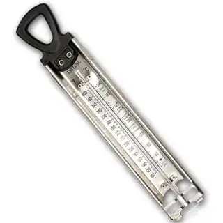

  • Sugar or deep fry thermometer. These are often marketed separately, but they are the same type of thermometer, and are generally inter-changable for either use (although sugar thermometers may be more accurate).
    They clip to the side of your sugar pot or deep fry pot. They are accurate for temperatures in at least the 200 F to 400 F range, where deep frying and sugar work is done.
    Some instant read thermometers are accurate at these temperatures as well, but they should not be left immersed. Read your individual manual.
