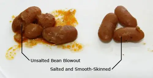

According to this extensive bean cooking guide from University of Alaska Fairbanks, the secret is to simmer the beans gently. Unfortunately, they have little more to say on the matter.
Kenji Lopez-Alt, in his column on Food Myths at Serious Eats says (emphasis added):
Most of us have been told at some point in our culinary careers that salting beans will cause them to toughen. It's incredible that this little bit of culinary mis-wisdom still lingers, for it couldn't be further from the truth. A simple side-by-side test can prove to you conclusively that salting beans (both the water used to soak them in and the water used to cook them) actually tenderizes the skins.
It's got to do with magnesium and calcium, two ions found in the bean skins that help keep the structure of the beans' skin intact. When you soak the beans in salt water, sodium ions end up replacing some of the magnesium and calcium, effectively softening the skins. Your beans come out creamier, better seasoned, and have a much smaller likelihood of exploding while cooking.
He provides this image of the contrast:
I believe the take away from this is:
  1. Pre-soak your beans overnight, as your grandmother did using salted water
  2. Cook them at bare simmer, stirring them minimally, to prevent physical damage to the skins.
The second can easily be achieved by placing the bean pot in a moderate (350 F, 180 C) oven rather than doing it stove top.

  • So it is a softened skin that is less likely to break, perhaps because it can stretch (if given enough time) than the harder skin? – Skaperen Jun 24 '13 at 15:17
  • @Skaperen I am not sure that is the exact reason, but it will be something similar to that. I certainly accepted his photos as pretty good evidence. – SAJ14SAJ Jun 24 '13 at 15:25
  • I would have expected the softer skins to be the ones to break up more. – Skaperen Jun 25 '13 at 03:29
  • It seems there are also reasons to NOT soak the beans ... http://cooking.stackexchange.com/questions/434/why-should-i-soak-beans-before-cooking/438#438 – Skaperen Jun 25 '13 at 05:55
  • How much salt in the soaking water? I'm intrigued. – lemontwist Jun 27 '13 at 01:03
  • Following the links through to Kenji's chili recipe where the bean experiment was first performed, 6 tablespoons kosher salt (or 3 tablespoons table salt), per 4 quarts of water. – SAJ14SAJ Jun 27 '13 at 01:06
