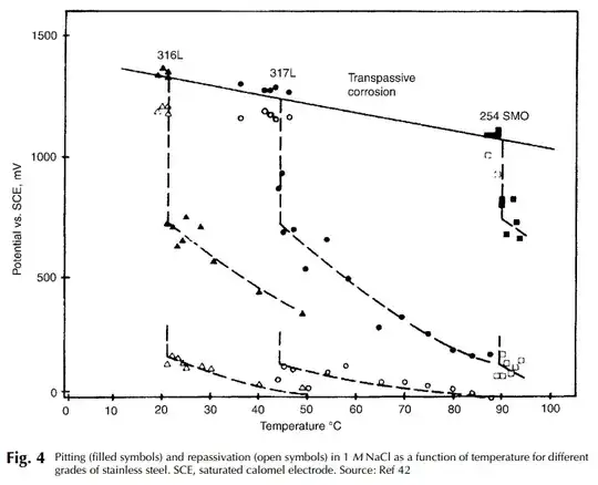

I'll get straight to the point by referencing this chapter on pitting corrosion from the Metals Handbook (textbook) which has the following convenient graph:
Pitting vs. Temperature
More pitting happens at lower temperatures. As the link explains:
At low temperatures, extremely high breakdown potentials are observed, corresponding to transpassive dissolution, not localized corrosion. Just above the critical pitting temperature (CPT), pitting corrosion occurs at a potential that is far below the transpassive breakdown potential.
But you can see from the graph that that's not the whole story, either. Excluding what happens at very high temperatures (above the CPT), the impact of temperature looks to be maybe 20-30%, but there are much more significant variations based on other factors, the most notable kitchen-applicable examples being the material (described as the PREN - Pitting Resistance Equivalent Number), surface condition (grit), and inhibitor elements in the solution (traces of which may or may not be found in tap water).
While this does certainly support the conclusion, it's also obvious, if you read the explanation of pitting or look at the lovely reaction diagram on page 2 of the textbook link, that it has literally nothing to do with undissolved salt. In fact, pitting is caused by the Cl- ions specifically, and so can only happen after it is dissolved in the water. If you just poured salt on a dry pan in a dry environment, it shouldn't corrode.
Moreover, pitting is a stochastic process - it's quite literally random even when you know all the other parameters, so while one can certainly average it out over many experiments and thus quantify the correlation with temperature, that ends up having little meaning in a kitchen setting because you are cooking with one pan/pot and the random variation seems to be a lot more profound than the effect of the temperature variable.

Short answer: Theoretically, yes, salt water at low temperature pits stainless steel faster than salt water at high temperature, although the popular explanation for the mechanism appears to be completely bogus. Practically, this factor is dwarfed by a dozen other factors and probably isn't worth worrying about at all. It typically takes thousands of hours for a pH-neutral, not-too-concentrated saline solution to cause any appreciable pitting corrosion at any temperature. What's more important is how clean the cookware is while it's stored, as that is the state in which it will spend the majority of its time, and as long as it's kept clean, salt-water temperature should not be a major concern.

  • Note: I'm going to review and possibly amend this answer tomorrow, when I'm less tired. I have a feeling I may be interpreting the data/graph incorrectly and that the higher points do not actually indicate more corrosion but rather a higher voltage required to cause corrosion, which would actually mean less corrosion at a constant (near-zero) potential in a heating/boiling pot - in which case the entire piece of conventional wisdom would be flat-out BS. If anyone else wants to double-check using the linked reference, please do. – Aaronut Jan 21 '13 at 03:57
  • Round here there are plenty of hot and cold thermal pools, some plain salt, some with whatever comes out of the ground. All with stainless steel rails and ladders, and they seem to survive OK – TFD Jan 21 '13 at 04:44
  • I read the textbook chapter and the graph... if I interpret it correctly, at low voltage conditions (as in a pot), repassivation events are common and pitting events are uncommon in the stochastic process. This would imply that the conditions in a pot of pasta water, even with salt on the bottom, coming to a boil actually give the conditions to repassivate (and thus essentially repair) microscopic pitting more than it does to create new pits. Am I reading this wrong? Materials science is far from my areas of expertise. – SAJ14SAJ Jan 21 '13 at 05:07
    @SAJ14SAJ: Bearing in mind I'm no materials scientist either, my understanding is that repassivation inhibits pitting corrosion but can't actually repair old pits; it happens at the same time as pitting, and needs a source of metal ions. See for example ...repassivation process in the inhibition of pitting corrosion... (abstract): "Pitting occurs when the processes of film growth and metal dissolution at the metal surface are kinetically related in such a way that complete repassivation does not occur." – Aaronut Jan 22 '13 at 00:20

The chart data is for 1M NaCl, basically 59 grams salt per liter of water , so a concentration you are never going to use cooking . Second , about 99% of SS cookware is 18-8 ( 301,302, or 304) there is a small chance of 316 SS. A voltage is applied to the SS and predictions are made based on the amount of current that flows .The information is intended to predict corrosion over a long ( months +) time , not 20 minutes boiling pasta. ...Short of boiling salted water dry ( in particular the last several minutes when the salt is concentrated to sludge or paste) , salt will cause no significant corrosion of SS cookware.
