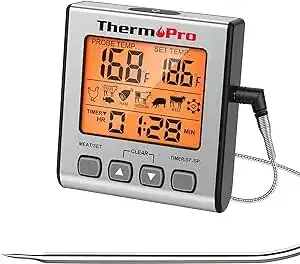

Flexible wire probe thermometer
If you can, get a digital thermometer that has a long probe wrapped in steel wire with a magnet on the back. They are designed to attach to the external door of the oven while measuring the temperature of a roast in-situ. Firmly clamp the probe so that it rests floating in the water (but not touching the dish itself) and attach the thermometer itself to the door or any surrounding metal.
That way you can a) calculate how far out your oven thermostat is and b) see how quickly your bath responds to temperature changes. As a guide, my water circulator increases at ~ 1 degree C per second (when the water cools from set temperature) in a 10 litre bath without insulation at ~ 22-25 C ambient. Your oven I suspect will be a lot slower to respond than this due to the factors others have mentioned. This way it will give you some idea as to how much longer you need to keep your recipe in the bath to compensate.
Once you have conducted these tests, I'd also suggest looking to acquire an enameled pot that you can unscrew the handle from the lid. That way you can insert and place the probe centrally while reducing evaporation. When using the lid in the oven it will assist in keeping the temperature stable.
