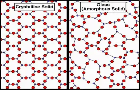

Good old H2O is a very interesting substance. The nature of its hydrogen bonds produces a bond angle of 107.5 degrees and a number of other curious properties (such as polarity, which allows water to dissolve many other substances). Notably, this angle doesn't combine or pack well into regular solids. Where other materials will solidify (i.e. freeze) into regular crystal formations, water's bond angle won't let it pack neatly; as it freezes, the molecules stack into jagged, irregular structures, producing a lot of microscopic spikes and sharp edges. The difference looks a bit like this (even though this shows glass on the right side, the concept is the same):
In food, those irregular edges mean that when water crystals form, they damage and tear your food on a microscopic level from the inside-out. That's why vegetables with a low moisture content tend to do best in the freezer (as stated in this answer) and why meat tends to get mushy if frozen, thawed, and re-frozen (as stated here). It's also why most every food will tend to lose moisture when frozen: water crystals poke tiny holes in cell walls, causing moisture to leak out and evaporate in a dry environment like the inside of a freezer. Interestingly, it's also why ice floats in liquid water.
