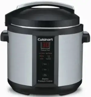

There are also the Electric pressure cookers, which are normal pressure cookers with built in computer controller heating and timing systems. These appear to be good idea, but the usually warning of fiddly electronics right next to heat and moisture apply. Some models have a variety of multi-stage cooking timers; including cooking while releasing steam (browning), keeping warm, time delay etc. A common complaint is that they cannot get hot enough, and are often rated at only 110°C

  • You might add a note about electric pressure cookers. They are convenient like slow cookers but they don't usually get to very high pressure. Usually just 10PSI which isn't enough for many recipes. – Sobachatina Aug 02 '12 at 15:30
  • @yossarian nothing on home page abut contest, when is this happening? In my experiences the difference with jigglers and gauges is very slight – TFD Aug 15 '12 at 11:58
  • @Sobachatina just checked around, no one seems to be complaining about electric not getting to 15psi, is this an North American brand problem? – TFD Aug 15 '12 at 11:59
  • @TFD- Could be, I suppose. I don't remember what brands I saw it about. – Sobachatina Aug 15 '12 at 12:18
