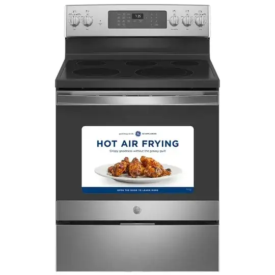

EDIT UPDATE: I understand the marketing behind the little countertop Air Fryers. I have one and enjoy it. It's great when you need a small quantity. My confusion is when large convection (fan) ranges advertise an Air Fry function. Such as this one: image of a convection range I'm trying to imagine the difference between convection (fan) mode and Air Fry mode for such a range. To me, I don't see any difference between fan mode and Air Fry mode--I'm beginning to think it's a gimmick so that they can charge slightly more.

Yes, when you switch the fan on, it is essentially a large air fryer. The only real difference is that air fryers have a smaller volume of air to heat, which makes them more efficient. It's not all just marketing hype, these little fan ovens do have benefits over large fan ovens.

Air fryers really took off during the pandemic as people suddenly started cooking for themselves more. There are a lot of people familiar with an air fryer that don't realize a convection oven does essentially the same thing. "Convection oven" often either means nothing to people or reminds them of the old toaster oven their grandma had with the mechanical timer you turn.
So if they want to attract that demographic who might want to make larger batches of their favorite air fryer recipes, marketers use the "air fry" phrase. I doubt "air fry" is actually a distinct mode from regular convection, although they might add some of the features of higher-end air fryers, such as food-specific presets.
