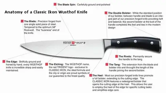

I'm trying to hone my Wusthof knife with my Grosche Zweissen 12 in. Ceramic Honing Steel.
